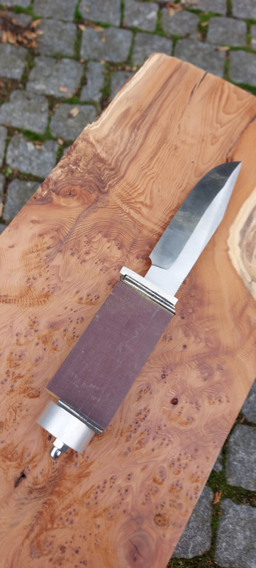

Fitted all the parts, checking for fit prior to epoxying. Both the pommel and the stainless nut (of course) have threads. Extra strong.
I believe Randall only places nuts on leather handles, but it seems like a nice idea to put one on a micarta handle for once.

Randall countersinks the SS nuts in the buttcaps...

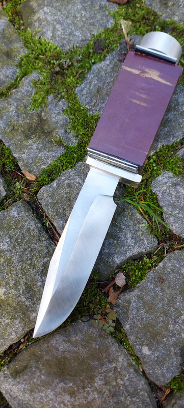

Epoxied all parts together.
Sanded the horizontal contour. Randall tapers a lot of handles from front to back. The Nr. 15 I have has a 7 mm difference in width. Did that with my version too.
After this the vertical contour.

Sanded the vertical contours and drilled the thong hole.
