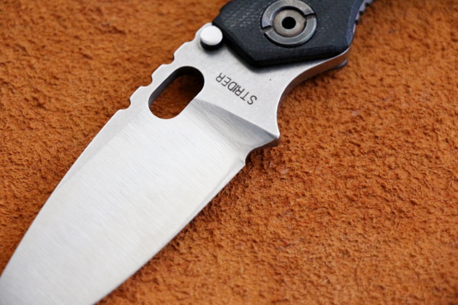

I received the package today, she rode for a very long time.
Now all the parts together! Here are some good knives.
As I promised, I will make a complex comparison with some hard tests.
Preparation will take some time, hope this will be useful for someone.
Hinderer gave me Lofty, absolutely new, thank you!
Strider SnG and Emerson Commander Mini I bought on ebay,
they are worn outwardly, but the mechanical part
is in perfect order.
upd.
On Strider was made a regrind to slightly tweak the geometry of the blade,
which was altered via previous sharpening

An interesting moment that is not listed on the site of Hinderer (in any case, I did not find it, but I see it with my own eyes and in many forums this is indicated) - working part of the lock plate (If the steel plate is not installed, as on the model Firetac) covered with something very durable, most of the opinions that it is tungsten carbide. This explains the fact that the stop plate at Strider wears off and Hinderer not wears off and the damage is obtained by the blade shank. The photograph shows a stain on the stopper plate in a more opaque color
