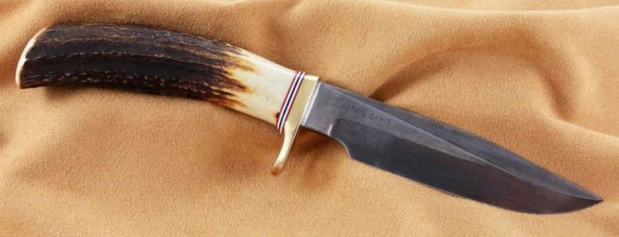

Everyone has their favorite choice in steel, except "me". I prefer stainless in Florida and for marine / wet condition work...Period. It just makes sense, "BUT" (There's that word again) , I also know how in the hell to sharpen a knife! I do an excellent job...really! Everyone at the huntin' camp. All of my mates, when I was commercial fishing, to the man, put me in charge of the knife sharpening.
If folks don't know how they need to do one of 3 things:
A) Switch to something soft enough to sharpen
B) Learn how to sharpen properly
C) Don't let your stainless get too dull!
Of the "3"...umber 3 makes the most sense...and not just for stainless. I laugh at the guy who brags about skinng out an elk and still being able to shave hairs from his arm. If you want to shave hairs from your arm...buy a Bic Razor! Keep a nice, keen 17-20 degree edge on your blade...keep it tuned up and you won't care (or know) if you're using stainless or carbon.
With every whitetail that I dress, skin, gut, butcher, etc. I touch up my Randall (or Randalls...sometimes I use more than one) several times. "Keeping" it sharp makes it easy to "sharpen".

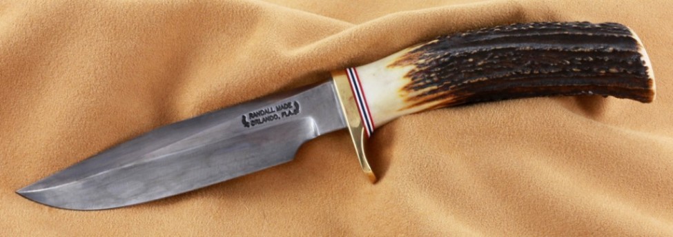

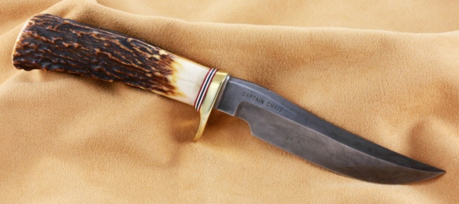

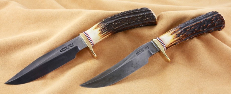

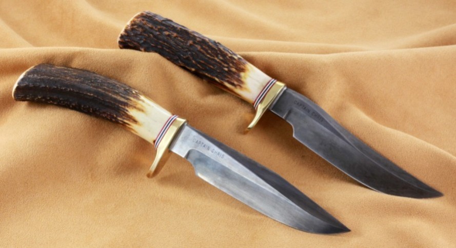

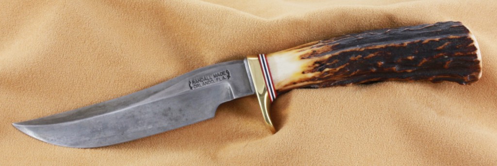

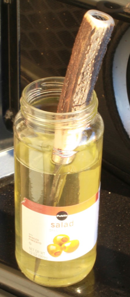

Also,JR3(?), you mention vinegar. I pickle all of my Randall carbon users (photos below). Pickling, vinegar, etc. retards the rusting, corroding, spotting process to the point that it is almost non-existant. When you mentioned no spotting on your carbon Randalls at first, you didn't mention the vinegar.
Below are 2 of my favorite Randall "pickled" knives. My #3 and #5, both with 5 inch blades...and "KILLER" stag.
Stay sharp, Capt. Chris

Captain, those pickled knives looked great! How long do you leave a knife in vinegar to achieve that effect?
Thanks to all for their input on this thread. Great information.
John
#96438 - 12/11/11 06:08 PM Re: Stainless versus Carbon Blades - Randall of Co [Re: JohnM]
Posts: 13195
I use pickle (in the case of the #5 Spanish Olive) juice rather than straight vinegar. I used vinegar once and it caused a bit more rust. The pickle juice does, indeed, rust the blade. Cleaning it afterward removes a good amount of debris and leaves the patina. I have more knives to do and will share that with you as time permits. (It "is" after all huntin' season / new RKCC to work on / Hi-ride project / website / forum attendance, etc., etc., etc.) I have left blades in anywhere from 1 hour to overnight. Start slow and work it! Glad you like it.
It should also be noted that gun bluing is also a rust process and eliminates, or in fact does indeed "retard", rusting of the firearm. Same principle...Mine's just a hair more redneck! Gotta' love it!
