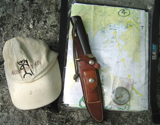

#82757 - 11/07/10 12:30 AM Re: How Stainless is Randall’s Stainless [Re: Leatherman]
Quote:
Camping in muggy august with a 01 blade...
Well, My 01 #5 has accompanied me on many summer camping, backpacking and CANOEING trips ...
first shot is of said #5 on the Moose River, Maine, in August (one of many canoe trips it has been on)
Second shot was taken after said trips. smile

#82777 - 11/07/10 02:18 PM Re: How Stainless is Randall’s Stainless [Re: Leatherman]
Quote:
You are not going to go camping in the back country for a week plus and not have rust... unless you are always taking care of your knife and not using it!
Sorry, I have to politely disagree. Not only camping but CANOE CAMPING ... FOR A WHOLE WEEK.
Used the #5 every day, including kitchen duty. And when it wasn't being used in was in a canvas thwart bag (not waterproof) attached to
a canoe cross brace right in front of my stern seat.
After each use ... washed with clear water and dried it with a rag ... or my shirt or pants. grin
I think keeping it clean and dry between uses is the key.

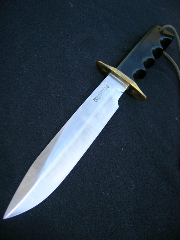

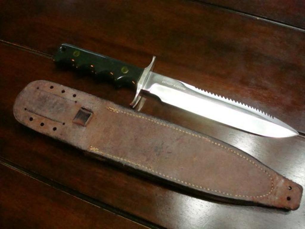

DW, I acknowledge all the above. That being said, the #16 with a double hilt is what the #16SF should look like, will do anything the SF would do, and look better doing it. A slightly downsized #14 if you will.
The #1 grind deserves a nice drop in a leather, stag, or micarta handle in standard shape or commando handle if you wish. It fits. It flows.
Kenifick was searching for a solution to a problem that didn't exist. Call me a tradionalist. My .02.
This is what a #16 fighter should look like:

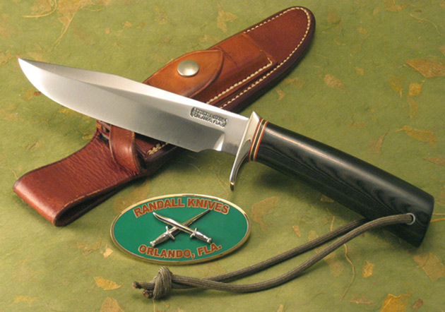

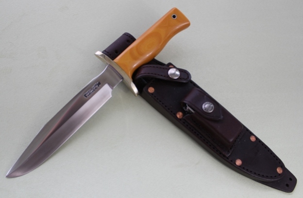

As much as I hate to disagree with the "Crutch" (and "others") I find the #16-7" Special Fighter a great addition to the catalog (and non-catalog...It's one of very few in "both") line-up! The arguements I've seen posted against it hold no water for me. What's the difference between arguing that the standard Model #1 design is the only way we should accept that blade design, and yet accepting the #14 and #15 "CDT" as being just fine? No Crutch: I know you didn't say that, but the point and question are both valid.
A Spl. Fighter carries less weight than a #14 and offers full, exposed tang construction. The most perfect fighting Bowie design ever, cloned with the most popular VietNam era design...Sounds like a "win-win" to me!...Just sayin'
PS: I ain't real wild about it in the standard (4 finger) configuration..."FOR ME"!!...CCS
Edited by Captain Chris Stanaback (11/09/10 02:24 PM)

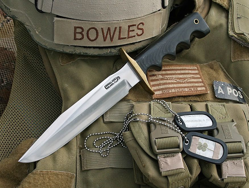

As some of you will recall my son Garrick, our original "RKS Special Fighter", took a model #16-SF to war as a Chief Petty Officer with Riverine Squadron One.
For ten months Garrick used the Randall on a daily basis in the tasks for which it was intended. Whether probing and prying into spider holes or hanging over the side of boat to clear a fouled net he found the model #16 Special Fighter to be supremely qualified for the job.
I'm sure that, like all warriors, Garrick takes care of his equipment so his equipment will take care of him. I'm equally certain that he has neither the time nor the inclination to fastidiously fuss over his knife yet, as you can see below, the Randall model #16 Special Fighter came through with flying colors. The proof is in the pudding.
