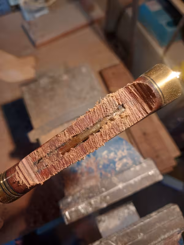

First remove the leather handle. I wanted to re-use the guard and the spacers.
[img]https://i.postimg.cc/hj097prY/temp-Imagekiqt7c.avif[/img]
Hidden tang is becoming visible. I bet not many people outside the Randall shop have seen this.
[img]https://i.postimg.cc/4Nyzmvh8/temp-Imageh8-EIEa.avif[/img]
