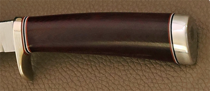

#207456 - 08/07/24 10:59 AM Re: RKCC "CLUB MEMBER'S" BUILD! [Re: LarryWW1246]
Posts: 7503
O1 steel
NS hilt squared
All red Spacers
Bird's eye maple
Border Patrol
Wrist thong
Compass
#207457 - 08/07/24 11:39 AM Re: RKCC "CLUB MEMBER'S" BUILD! [Re: pappy19]
Posts: 13145
I have/had already mentioned earlier, in this build, the advantage of O1 tool steel, vs. SS when sparking is called for. No question...Carbon wins!
Hope this helps,
#207458 - 08/07/24 04:27 PM Re: RKCC "CLUB MEMBER'S" BUILD! [Re: Captain Chris Stanaback]
Posts: 1849
...duralumin butt cap that's been "thin" and radiused. No extra charge when you order the duralumin butt cap...(but, of course, the butt cap is chargeable).
That's a GREAT handle look, Captain!
#207459 - 08/08/24 01:53 AM Re: RKCC "CLUB MEMBER'S" BUILD! [Re: Holzinger258]
Litch Offline
Does the thin and rounded butt cap still allow a thong hole?
#207462 - 08/08/24 09:34 AM Re: RKCC "CLUB MEMBER'S" BUILD! [Re: Litch]
Posts: 13145
Absolutely!
C
