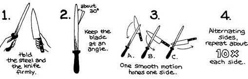

Posts: 1871
Knife steel

#204555 - 07/11/23 06:59 PM Re: Knife Sharpening...HELP! [Re: Captain Chris Stanaback]
Posts: 1871
You're right, Captain. Honing with a steel doesn't remove metal, just smooths and straightens it.
(maybe if I remove enough steel by power sharpening, I'll have an excuse to buy a new knife!)

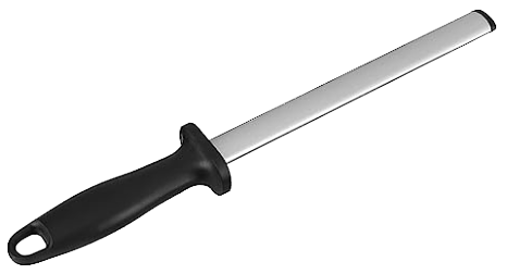

Posts: 1871
One of my steels is even harsher--my Professional Extra Fine Oval Diamond Sharpening Steel may say "Extra Fine," but it DOES remove steel. I don't use it as much now as I used to.

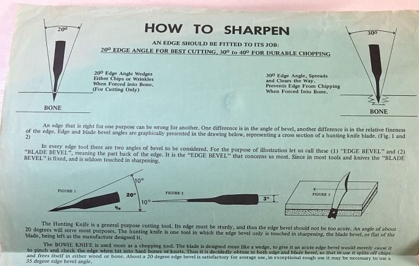

Oh, thank you so much Capt Chris for sharing. As for the angle, this is the most important smile
I also like the instruction from Ruana, I added the scanned leaflet to the message. And after sharpening, sometimes a burr or a wire edge remains, here is a good way to remove it from 12.5 minutes
https://www.youtube.com/watch?v=8FqUL6slhtA&t=764
True, he does not say anything about the constant angle, but it is clear that he observes it
I use only stones lately, there are different, artificial abrasives and natural ones. For Randall, my favorites are Crystalon, India from Norton and Craftsman and Sintered Ruby by Gesswein for end sharpening

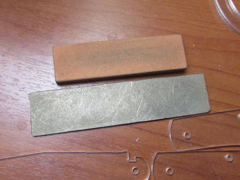

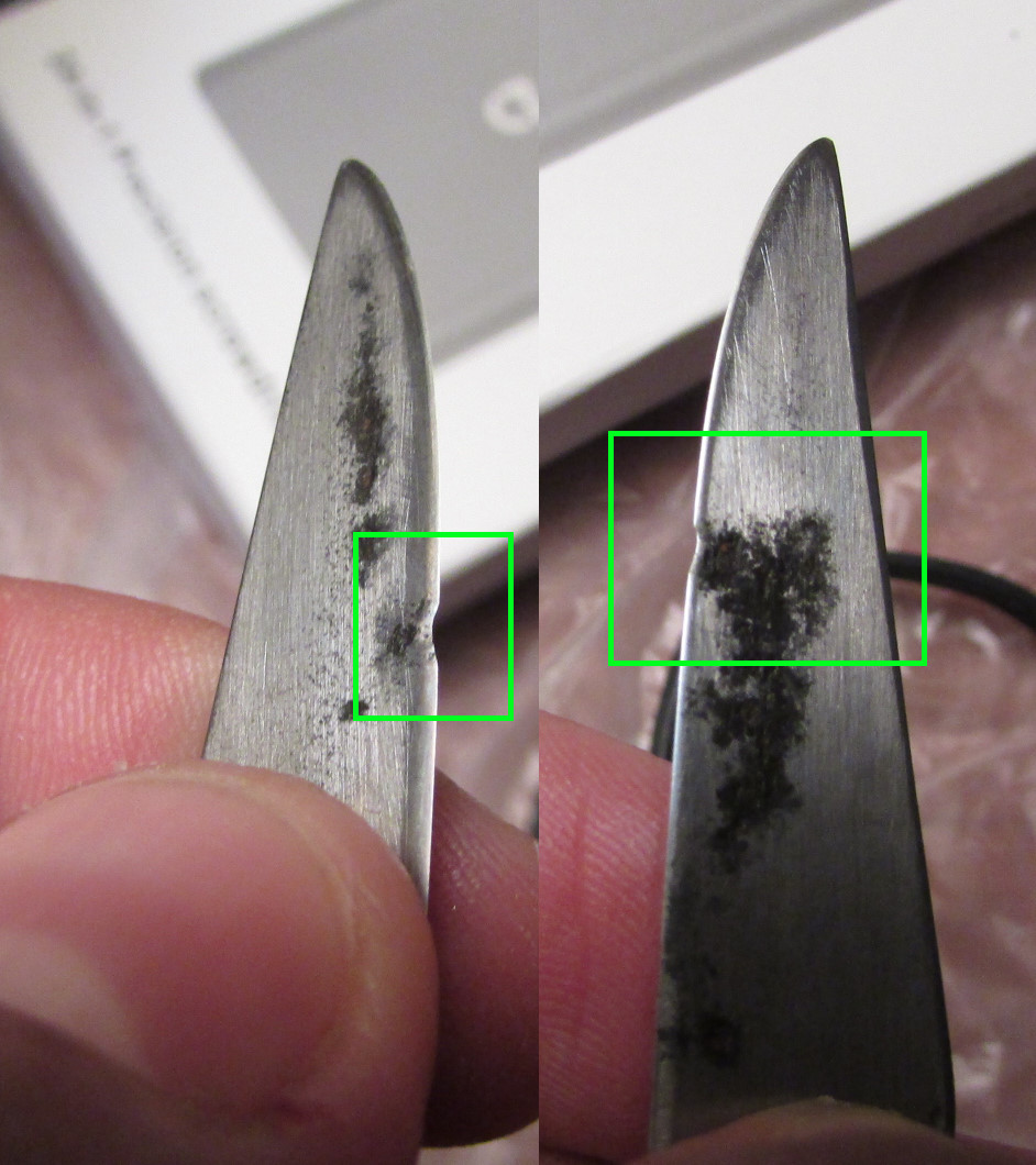

A couple of days ago the unexpected happened. About 1.5 weeks ago, a friend gave me a Fox Vulpis pocket knife with M390. I used it and it finally got dull. Moreover, he became dull at a fairly simple task - sharpening a bunch of pencils for a friend's children while I was visiting him. Lol. At first I tried Arkansas, since the dullness was slight - it had the opposite effect, it stopped cutting altogether. I tried a ceramic triangular rod from Lansky - no effect. I went to Norton Crystalon Fine, he sharpened it, but the edge was rough. I switched to Fine India, the results got better, then I switched to Arkansas and again the knife stopped cutting and became very dull. That is, it seems to be sharp, but if you need to cut something like vegetables or meat, then it slides along the surface. An internet search brought me to this site. A guy with an electron microscope sharpens knives and looks at what influences sharpness and subsequent dullness. Perhaps this will be interesting to someone:
https://scienceofsharp.com/
After reading everything and thinking, I came to the conclusion that this steel is hardened very hard and dull due to the fact that when moving from India to Arkansas, I cannot maintain an even angle and lateral pressure spoils the base of the cutting edge and it falls off already in the process sharpening. As a result, I again came to what the Captain described at the very beginning - need to keep a constant angle grin
Then I took Fine India again, a black marker, so I could see where the metal was being removed, and sharpened the knife, trying to do it with very little pressure. As a result, the knife is very sharp. I don't see the point in switching to smaller stones. If I had a Norton 313 in the first place, I would have saved a lot of time
Along the way, I also bought a rather unusual diamond plate; it is made of bronze or brass and the diamond is distributed inside it evenly throughout its entire volume. It sharpens somewhat rougher than India, very similar to Crystalon Fine. Together they are a great couple
