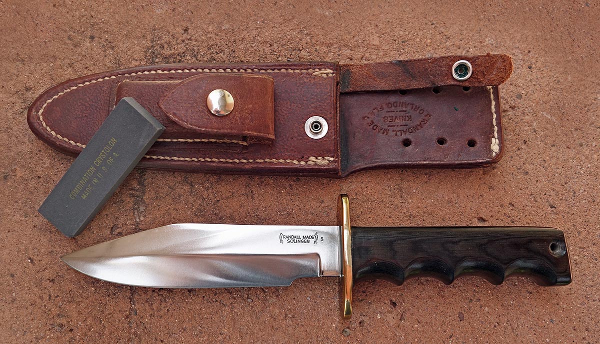

Can anyone shed light I what I have here? It’s a Model 14 Solingen but without a hump. It doesn’t appear ground down but not 100% sure. The seller called it a “deleted” hump which I’ve never heard of. I hope it isn’t a “humped” knife.
Other particulars, split back Johnson, combo gray stone no writing, unlined thong hole and plugged Micarta.
Thoughts?

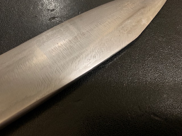

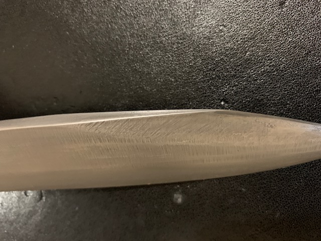

#180961 - 06/19/19 09:22 PM Re: Solingen 14 Hump Blade w/ no hump? [Re: crutchtip]
Jon_Peterson Offline
Registered: 03/16/06
Posts: 160
Loc: Denver, CO
Couple of close up shots of the “hump” area
#180963 - 06/19/19 10:22 PM Re: Solingen 14 Hump Blade w/ no hump? [Re: Jon_Peterson]
Posts: 2860
hard to say 100% without the knife in hand, but judging by the grind marks all over the blade, it appears someone ground the hump mostly off.
