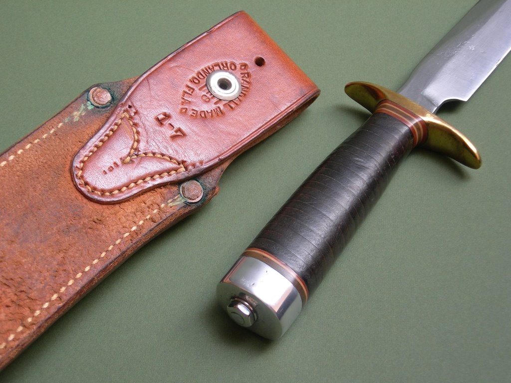

Looking for feedback on a sheath that came in on a consignment knife. I'm thinking the throat rivets aren't original and I don't want to misrep anything when I list the pairing.
Your thoughts?
I know the back part of the snap showing through the RMK logo is not original, that's a given!

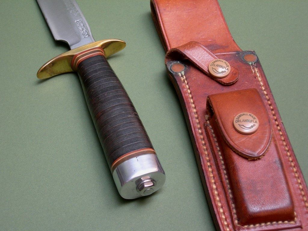

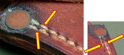

Seems like both sides of the throat of your sheath were reinforced using "return" stitching, so no real reason for the rivets to add more reinforcement. I believe the second picture shows properly riveted sheath.

Yes the rivets have been added. Sheath did not come that way.

Beautiful old Mod. 1 that someone screwed the sheath probably to deceive.

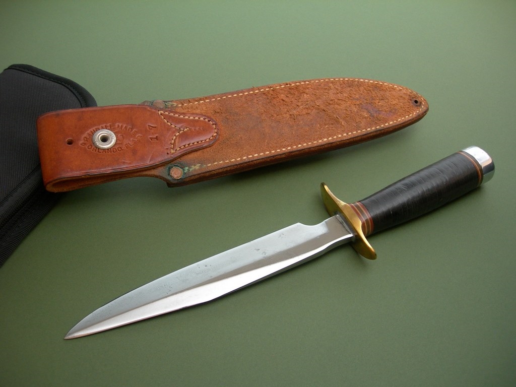

It appears to be an HKL sheath, not a Johnson. That being said, the rivets have been there a long time it seems, and are period, so it is difficult to say 100%. It is most probably an owner modification.
The Randall shop set keeper snaps, they didn't make sheaths or add rivets I know of, and Mike's story of adding rivets is the first I have heard of. I wouldn't think the shop even had the tools to do so. In fact, I would bet money on it.
In any case, I don't think it really detracts from the package, and I wouldn't look at it as a negative.
What is odd, is the washer/nut for a knife apparently that late, or an HKL sheath with a knife that early. Depends on how you wanna look at it.

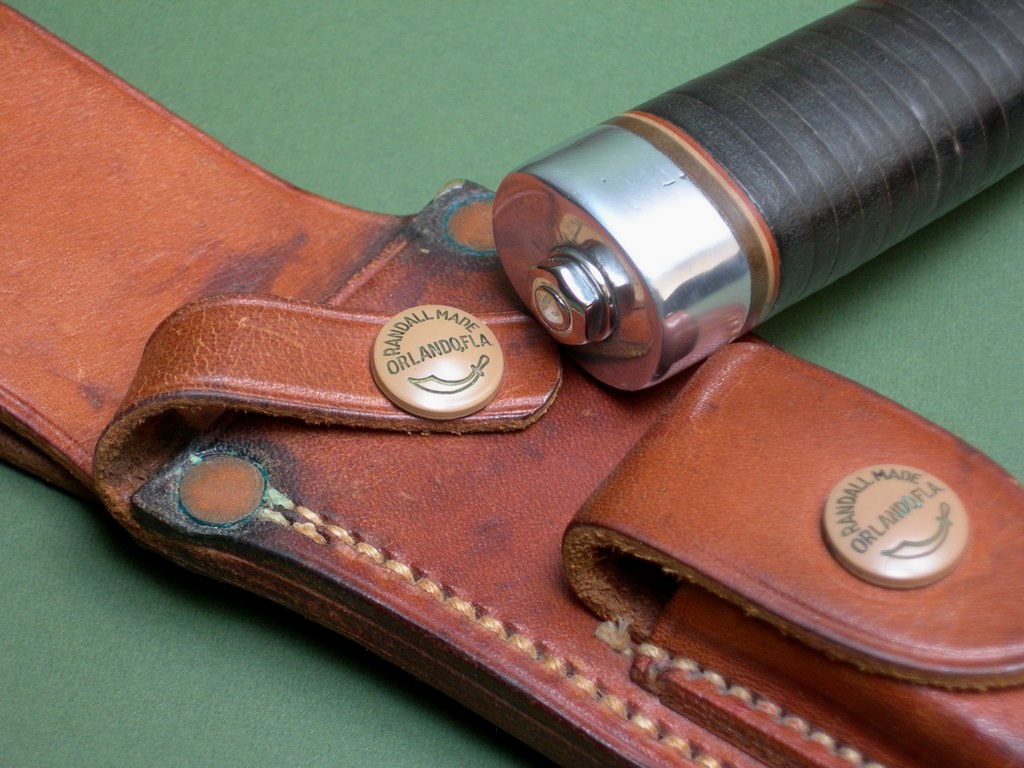

The rivets in Miles’ sheath do look to be old…and without any other information we have no reason to think they are not as old as the sheath itself…and they appear to be professionally installed.
Maybe Pap can tell us whether the rivets in his sheath were installed to look like those on Miles’ sheath?
I think the real mystery is why was the gadget installed in the back of the belt loop? What was its purpose? It does appear to be “aftermarket” (not done by Johnson or RMK) since it is in the middle of the Randall trademark!

Just a guess, the receiving end of a dot snap on a cartridge belt?

The sheath in question is not a Johnson, it was made by a different company, prior to Maurice Johnson's relationship with the shop. Therefore, referencing Johnson as not installing the rivets is moot.
I do not believe Pete was "set up to add them (rivets)" at the shop. Not in the least bit. Again, it has repeatedly been confirmed that RMK was not and is not in the sheath fabrication or modification business. Could he have done so? According to Mike, Pete did on his sheath. I think the question is why would Pete even ask Mike if he wanted rivets? It would seem odd unless there was some conversation that Mike thought his potential use of the knife might require rivets. Regardless, why not just get him a period model "C" sheath for a model 1 from the bin and exchange sheaths? Why add throat rivets to a model "A" sheath?
It appears the female portion of a snap on the belt loop was added as a method of attachment it would seem. The fact that it probably is not original to the sheath might indicate the rivets are not original either.
The real mystery is the gap between the knife and the sheath age wise.
