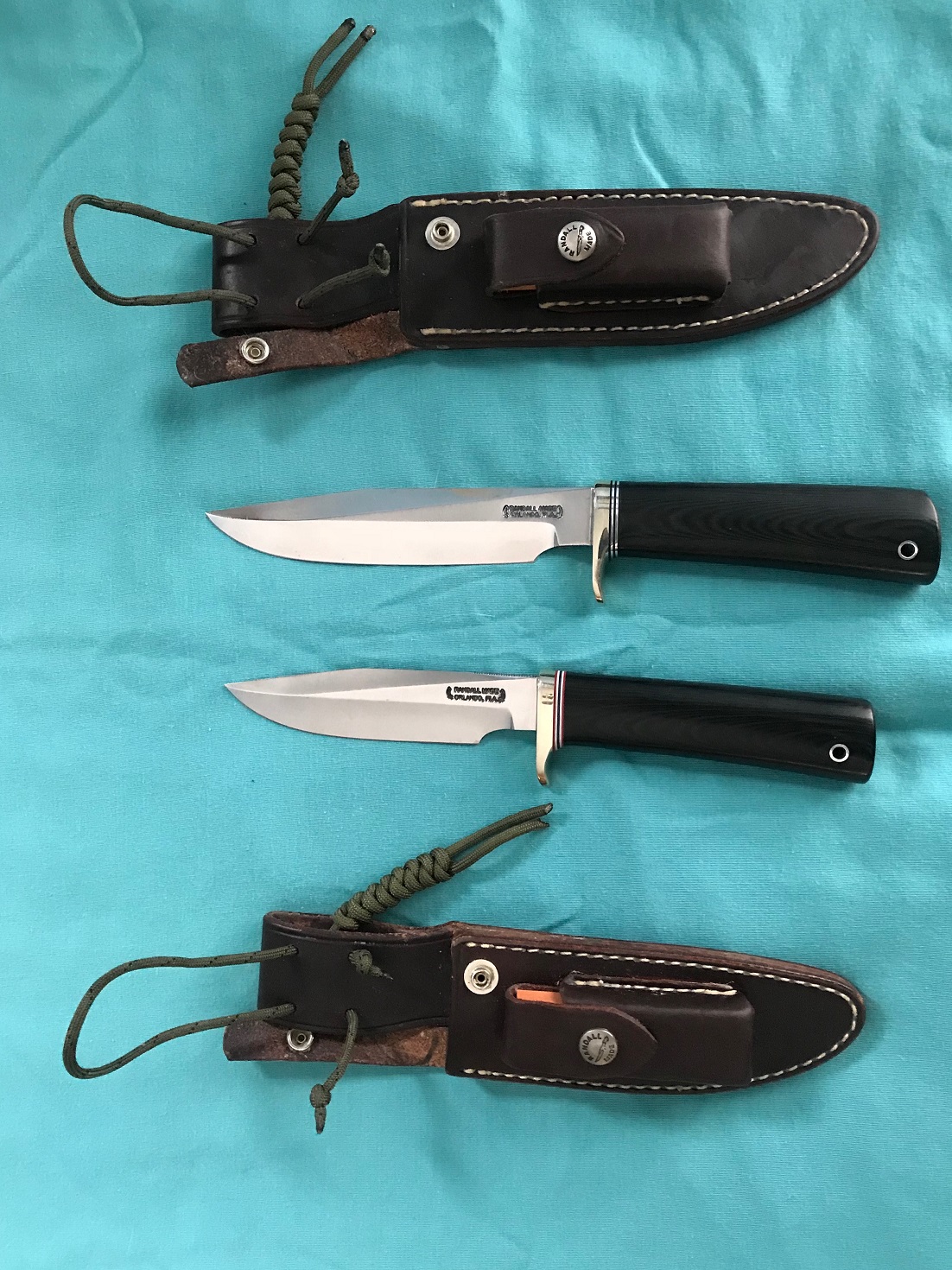

Good info. I dipped two of my sheaths in melted beeswax. Came out nice.

Pics?

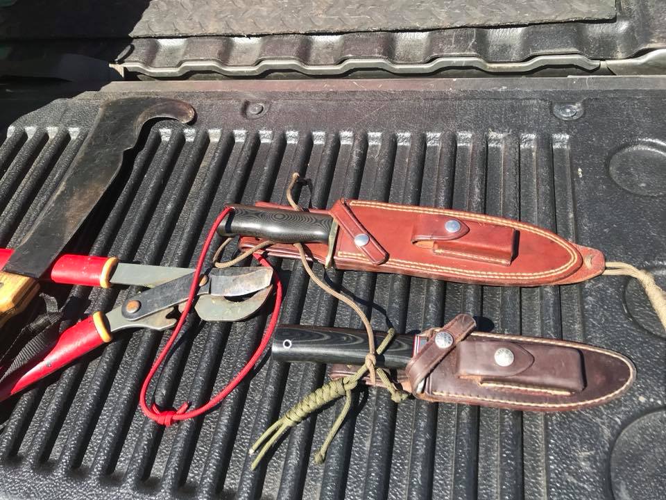

I uploaded your pic Jim. Nice work on the wax process.
