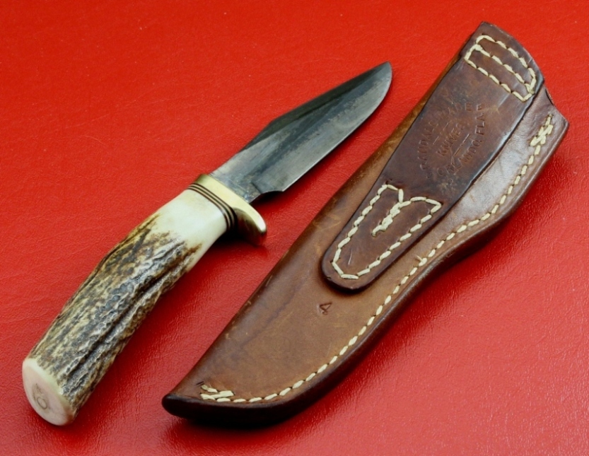

I just posted this older Trout-N-Bird to my website but thought ya'll might like seeing my latest pickling chore!

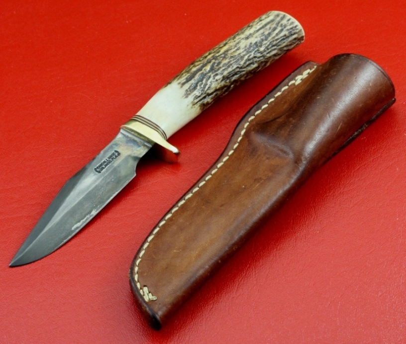

This #8-4" was traded to me by a good customer who likes bigger knives. It was unused and never been re-sharpened but had a couple of "stains" (not black carbon spots) on the blade.
I pickled the blade...twice...coating the blade after the second "dunkin'" with the Randall shop knife oil. It came out awesome, I think!

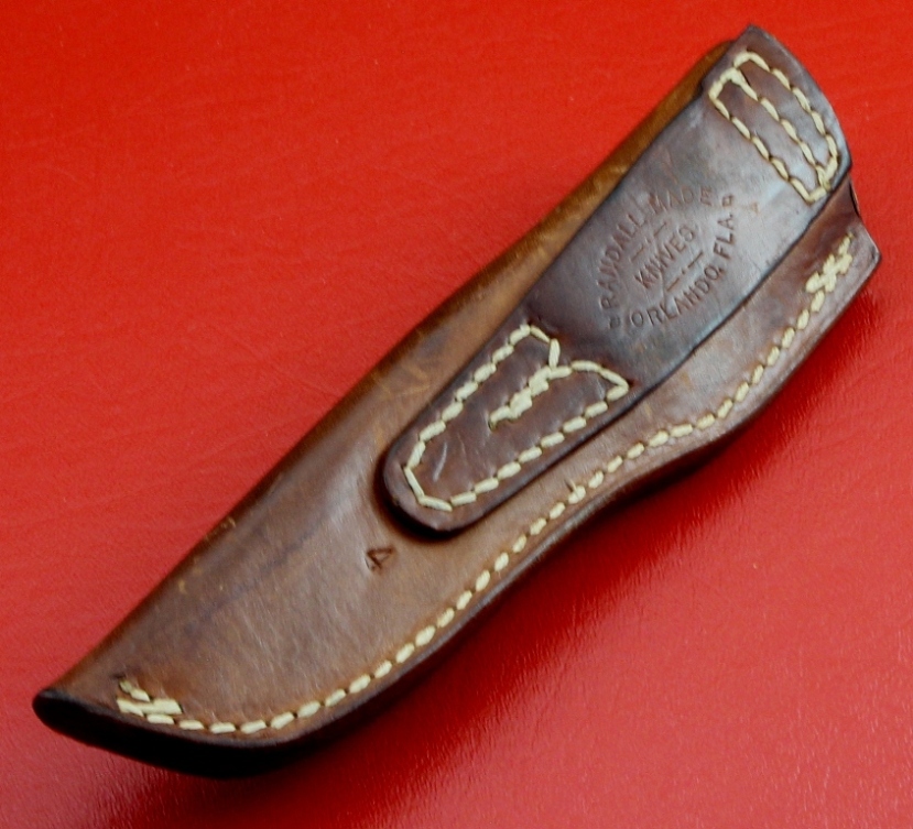

This knife is 1980's vintage and features one of the old Johnson "pouch-styled" sheaths! Still...to me...it would make somebody a great EDC/USER...so I pickled it to prevent rust, etc...
Hope you like it!
Happy New Year, Capt. Chris

When I was a fishing guide in the Yellowstone area the summer of 1975, I used my #8 every day for 3 straight months. It is still my go to Randall when I go trout or pan fishing. The only thing I would add is a wrist thong. I could drop the knife, gut the fish and not have to put down the knife, plus the thong makes it easier to extract it from the pouch sheath. Nice pickle job too!!
