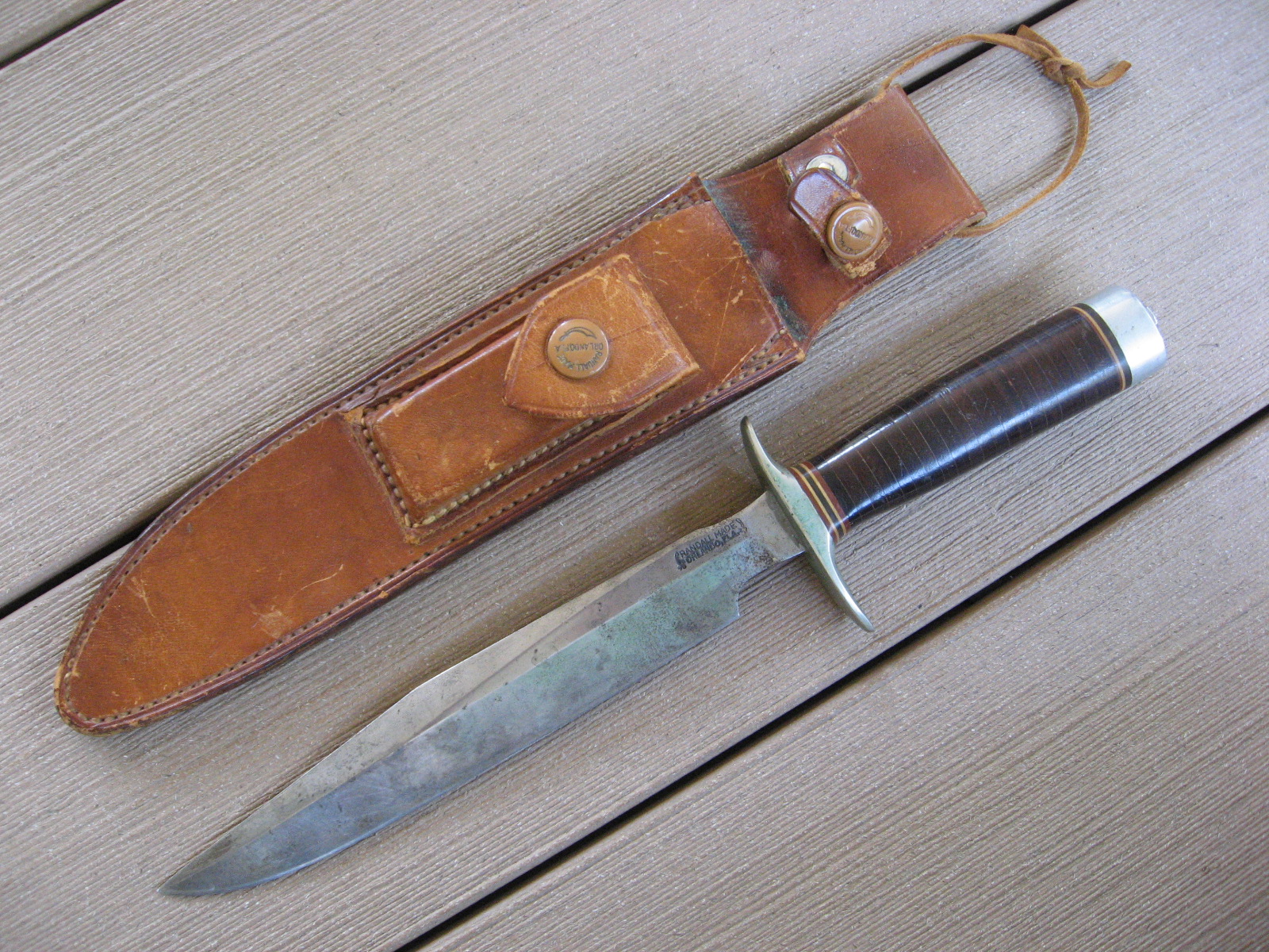

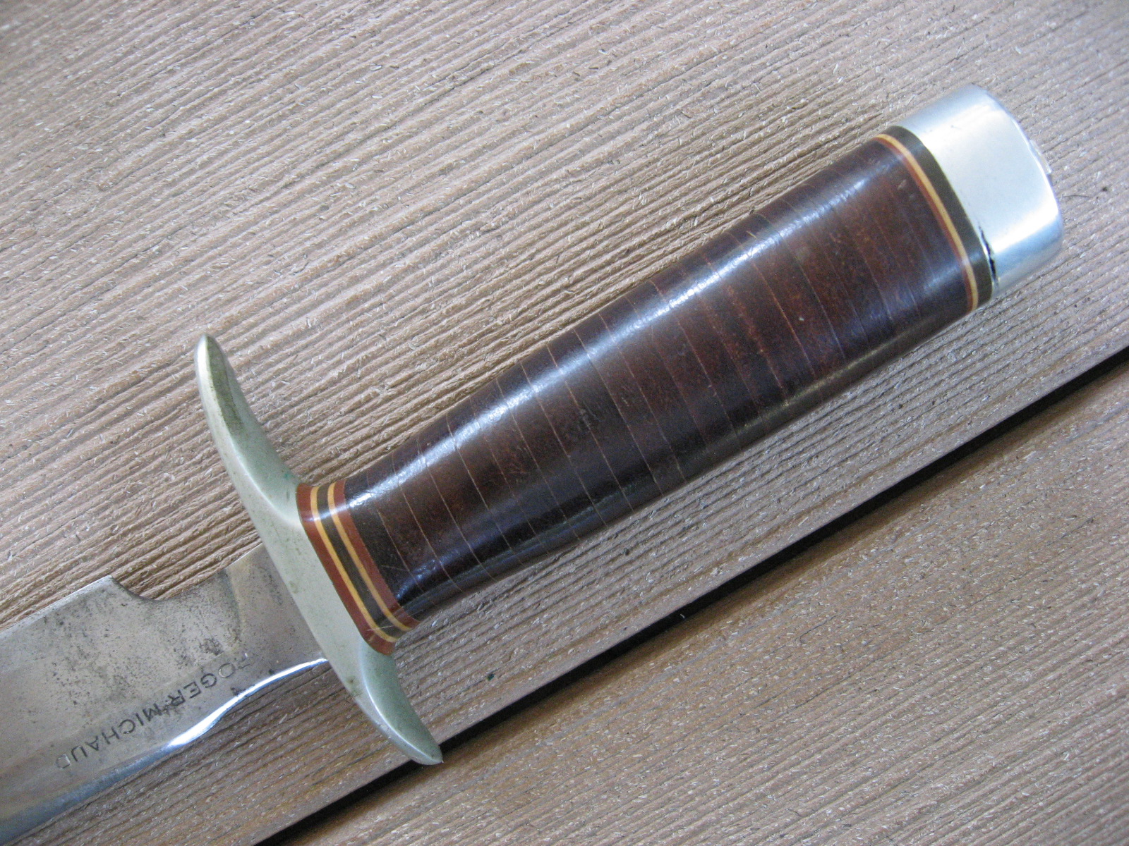

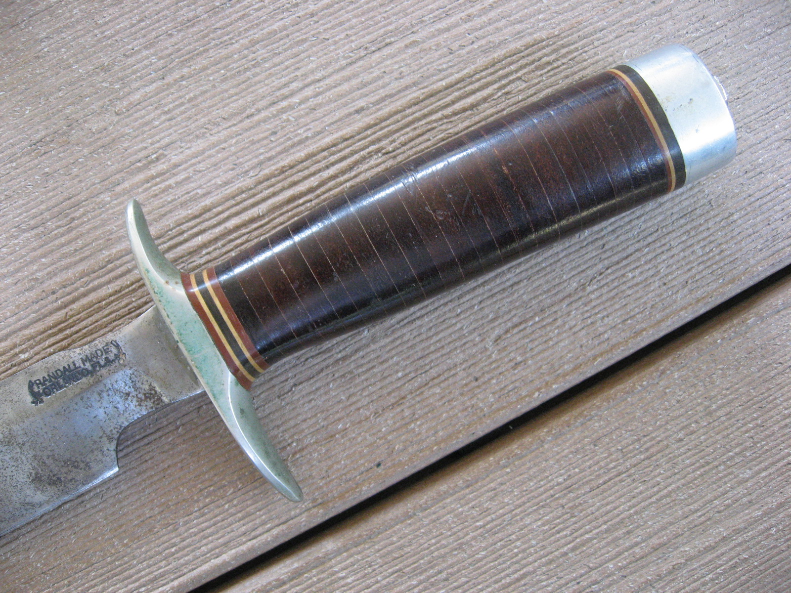

Just acquired this knife and would appreciate any Input on It . I was thinking maybe late 50's vintage ? I was surprised the guard Is not brass , maybe nickel ? Also wondering about the spacer configuration at the pommel end with very thin red spacer. It does not appear to have been apart or messed with . Thanks guys

Early 50's nickel silver hilt nice knife.
#173682 - 08/08/18 08:28 PM Re: Another #1 Randall [Re: Ironworker]

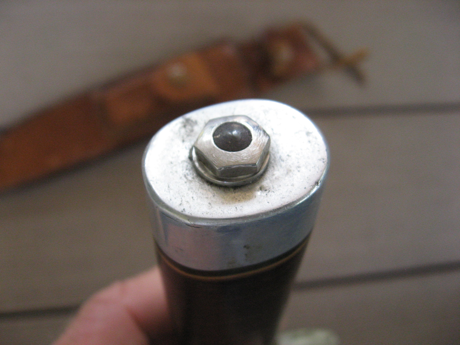

With the more pronounced clip and steel washer I lean towards the late 50s. Mid 50s spacers are more equal in thickness and early 50s often have brass washers if not both nut and washers of brass. Nice knife, If Tune or Crutch chime in take what they say to the bank.

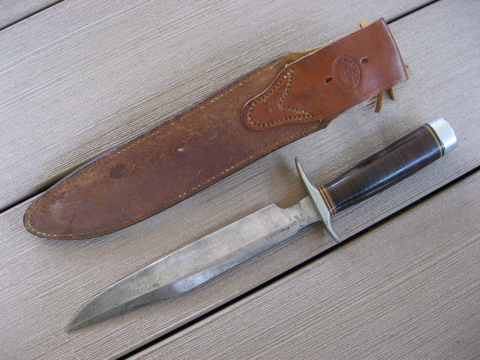

Early 50's . Heiser Sheath with large stone button flap is early 50's . Knife has Steel nut and washer which is early 50's . Mid or late 50's the knife would have acorn nut and sheath would have slim stone button flap ?
crutchtip , does that sound right ?

Keeper strap wraps around the handle, late 50's goes over the hilt.
sounds about right.

Duly and well corrected I am about the acorn nut. I can't really tell if it's a wide flap though. Good eyes, William, Walter, Joe, and Ben!

Heres the stone , to complicate matters . Looks like a 1940's type which I know the knife Isnt . I believe Its a wide flap cover .
