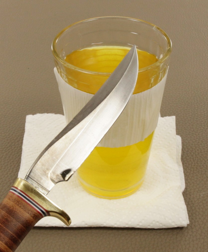

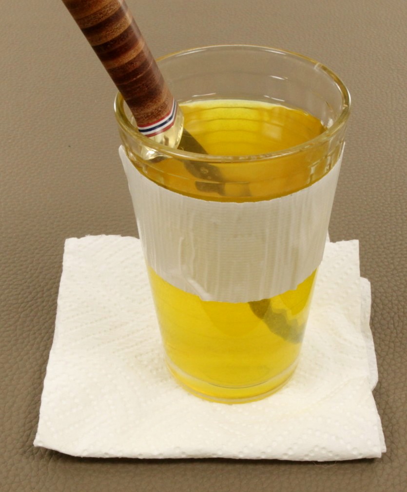

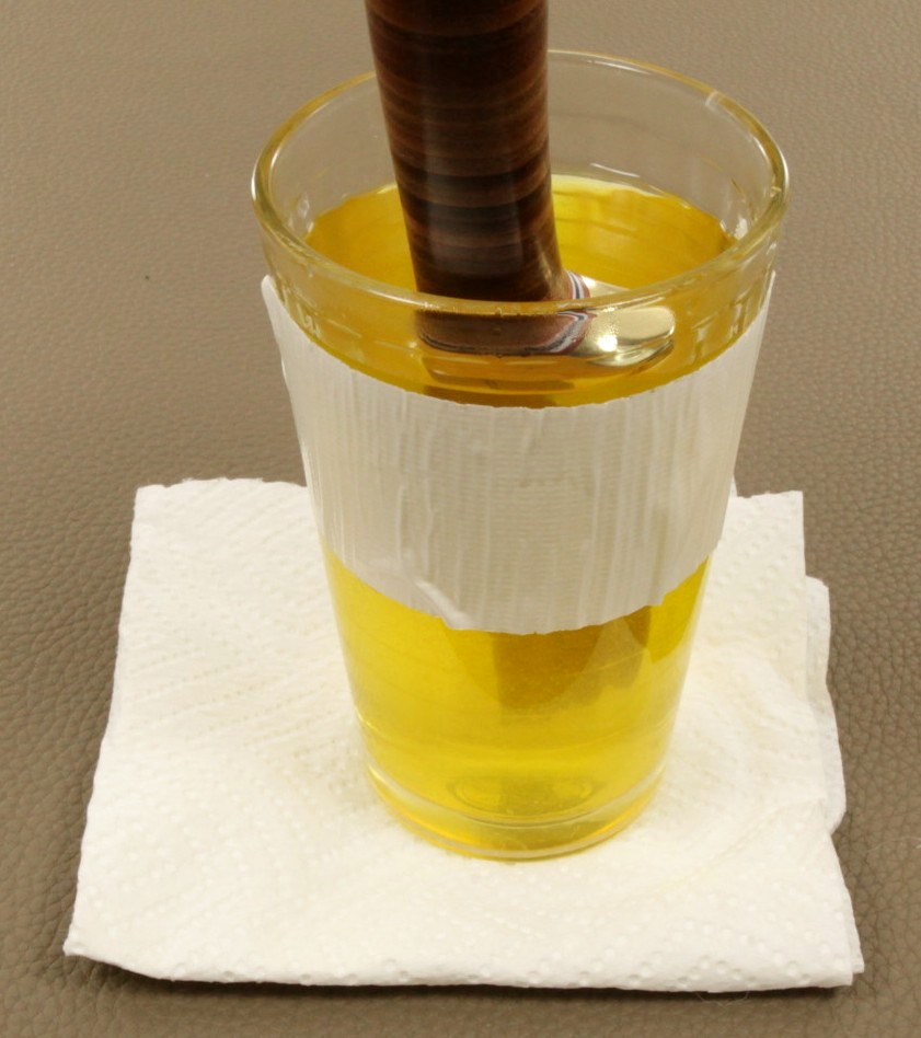

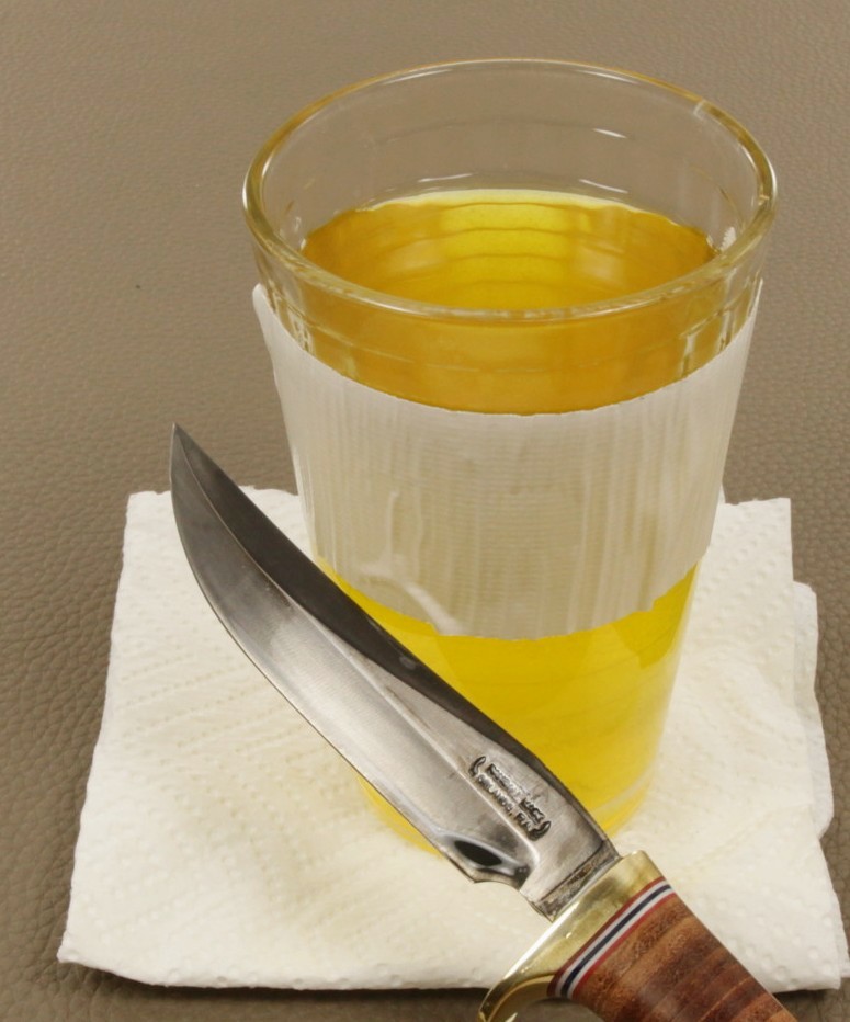

...Changing the position of the knife, every now-n-then...you can see the results at 15 and then 30 minutes...

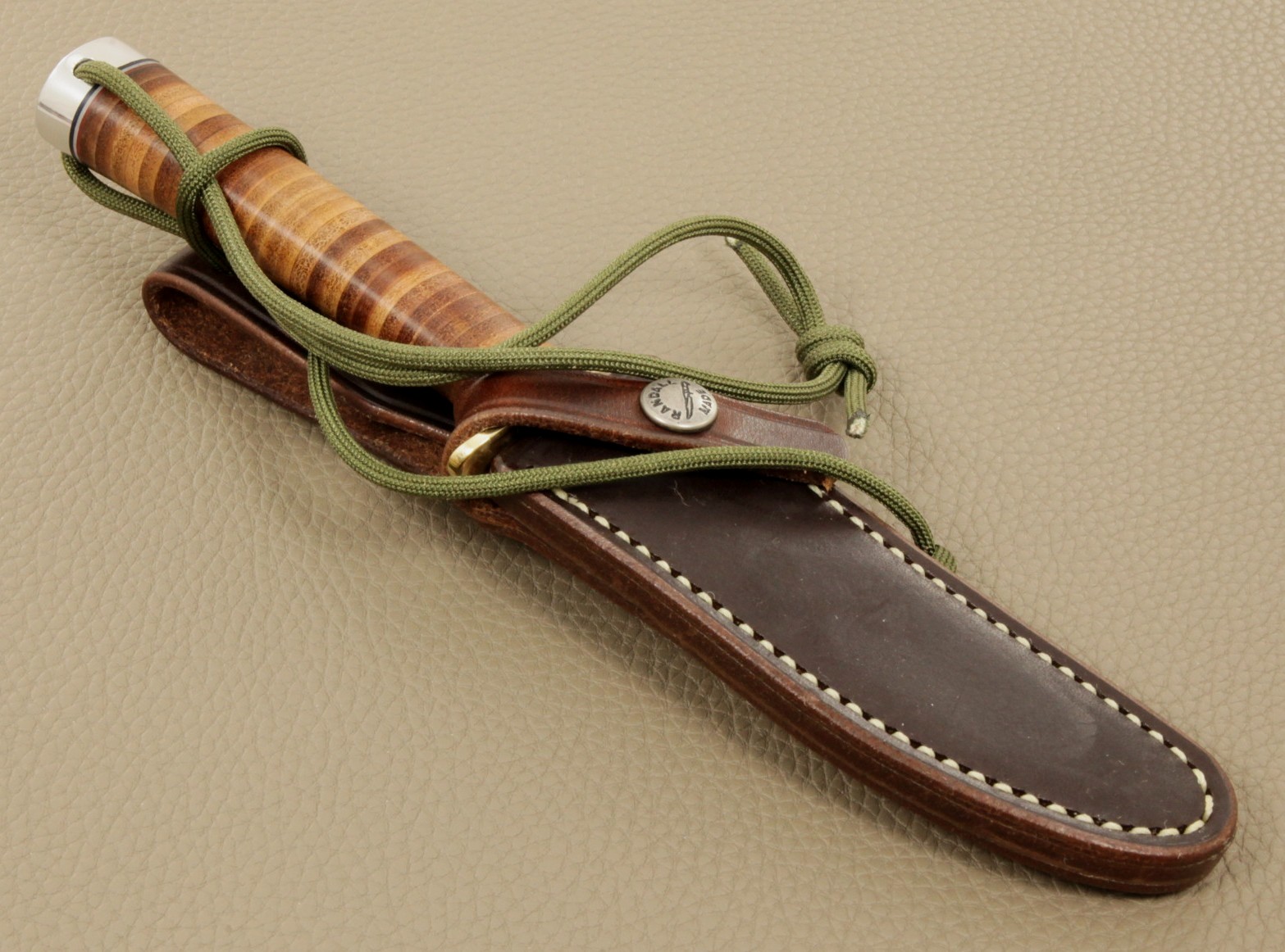

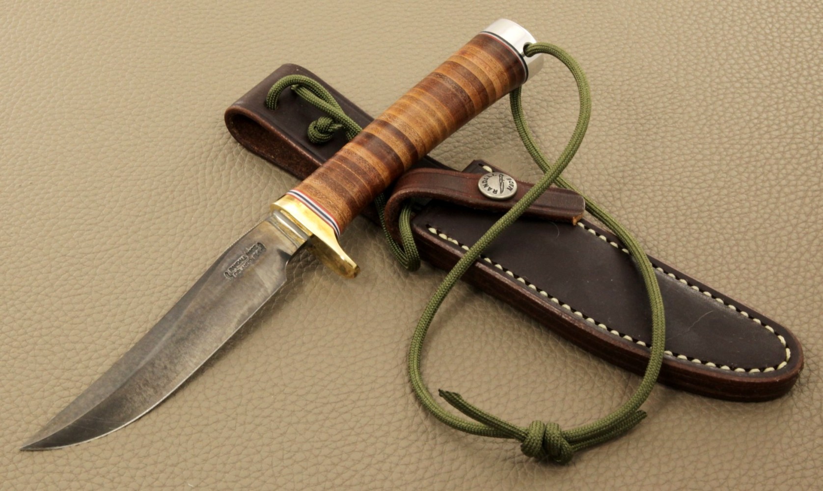

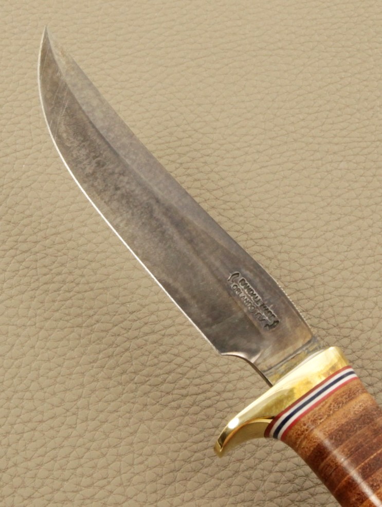

....All done...All in...Total time, from start-to-finish was 1 hour! I took a small Randall pocket hone and touched up the edge after washing the knife. It's a done deal! If you are not crazy with this look you can:
* Leave it in longer or shorter, giving it more or less "darkness"
* Sell your carbon knife and order one in stainless steel!
This will give my customer some very functional use for the rest of his life. Hope ya'll enjoyed the trip.
