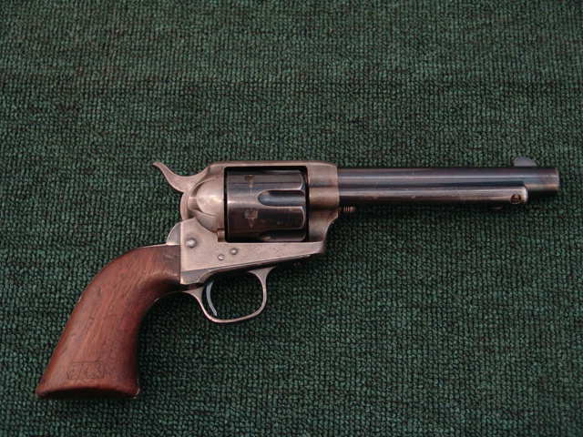

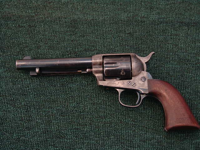

Mine "always" come out uneven. That's what I like about them! Ever seen a single-action Colt with only one, nice, even, non-mixed color case hardening? (& folks pay a boatload of money for them)

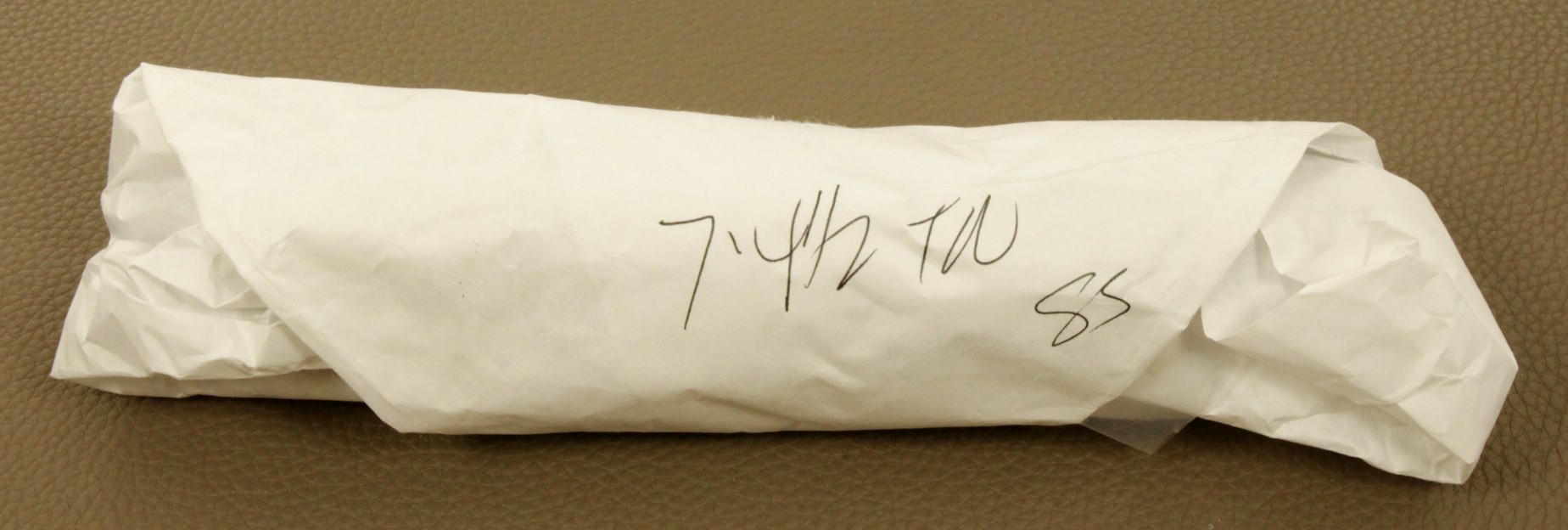

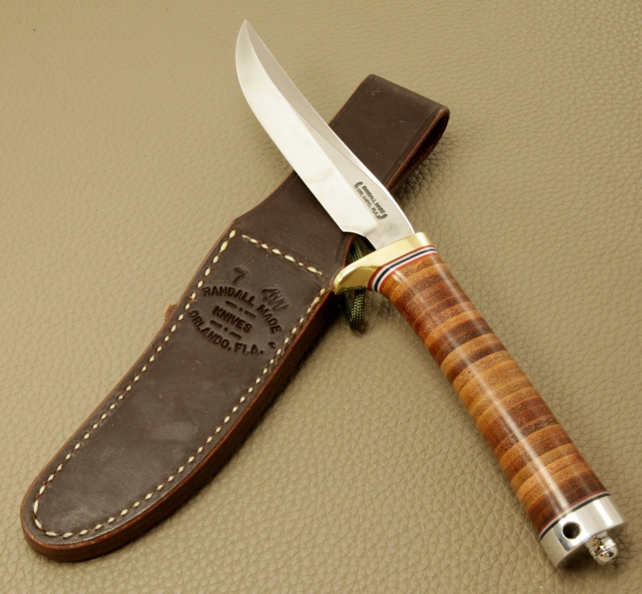

1st: Starting with a #7-4 1/2", thumb notches...(added a wrist thong and a waxed sheath, per the customer's request).

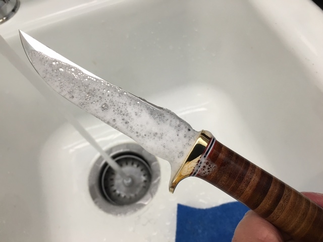

2nd: After un-wrapping I simply washed the blade real good with warm dish soap and water.

Single action Colt
