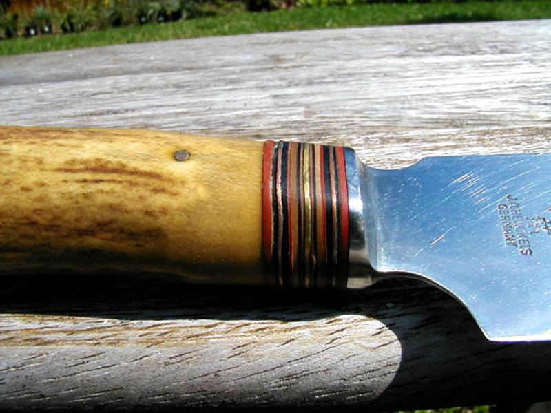

Perhaps, but the blade grind appears a bit later than that when compared to those pictured in photo 43 in Gaddis of 1940 knives. That being said, the "fancy" spacer arrangements are a variable in my eyes. You recall the Henckles carver I sold you had around 18 spacers to include copper and brass, "fancier" than both yours and John's knives. Not as large in diameter as a knife with a hilt would have, but the quantity was there. So again, it is a variable to me, as are allot of things RMK.

How can anyone argue that fancy spacer stacks are not variable. One only has to look at photo 41 page 44 in Gaddis book how they were reduced in stack count over time. The point being that John's stack does not preclude it from being '39 or '40 and more importantly seems to be typical of this period.
