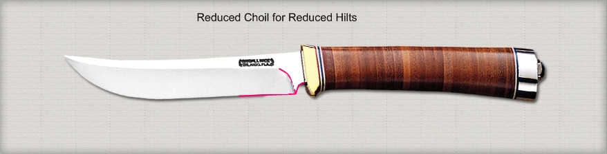

As for the topic itself, I have a few ideas that could be improved, such as the thickness of the blade in some cases it was possible to make a 2.5-3 mm, instead of 1/4".
Or models, if set reduced hilt, then reduce choil or just do removed it up)
I think Bo, Gary and other developers have managed to find a very successful form of design to meet specific needs most users.
Certainly, every person has some thoughts on upgrading his instrument personally for themselves. Therefore, proposals may be millions variants.
With regard to China and India - billions smile smile
