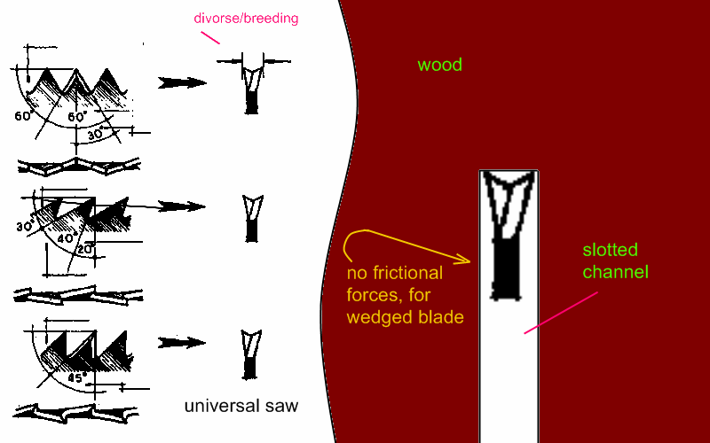

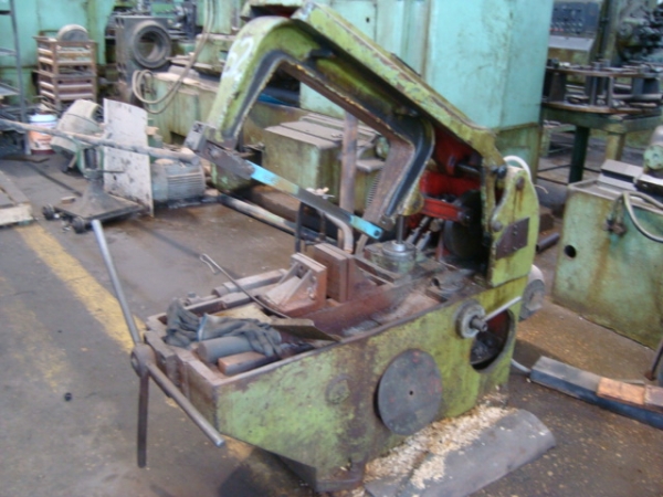

Very interesting topic about teeth smile
I was interested in one question, it's not about the size of the teeth, but about the form teeth.

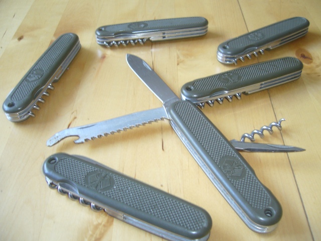

I see saw wood on folding knives Victorinox. They are very well
sawing wood. Saw a lot of saws for metal - aluminum, steel, copper.
All saws have teeth divorce. As in the pictures below.

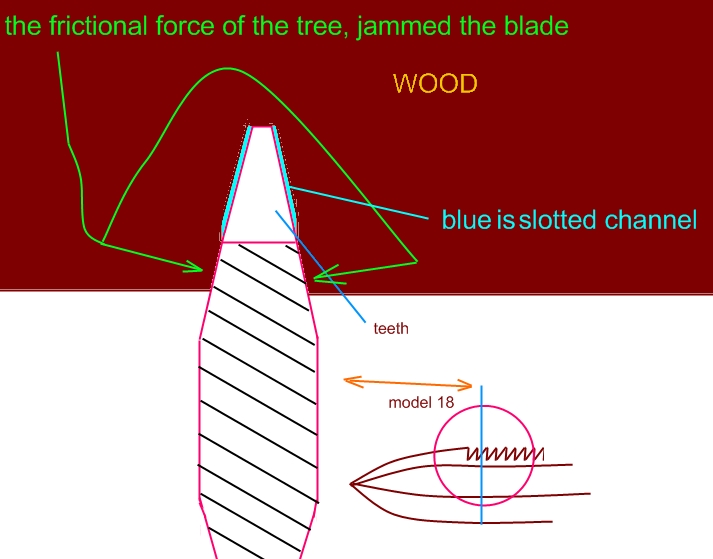

On the knife Randall 18 I did not notice of any divorce.
So the question for those who enjoyed the blade of the knife
does not clamp in wood or metal, at a time when the saw teeth
will drop in its height?

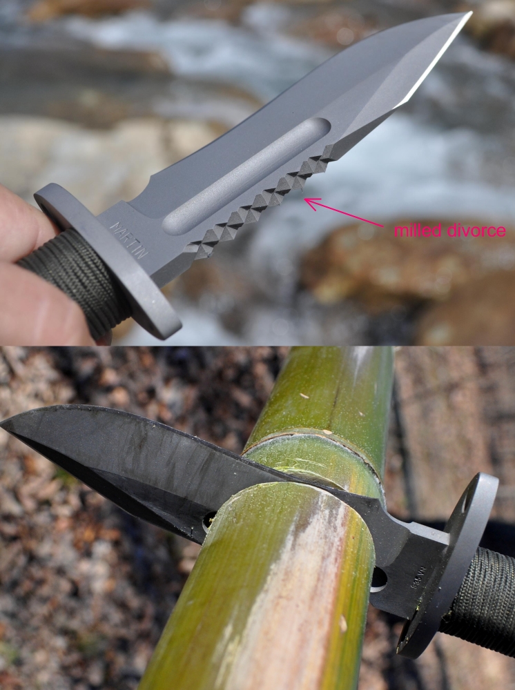

The blade Iz Turley and Ed Martin and other has rubbed saws,
but they come with divorce. I think they are well-sawing.
But design #18 I like more smile

just what I wanted to express my pictures:
Description: saw blade for metal
Description: mechanical saw like http://www.ebay.com/itm/321615712150

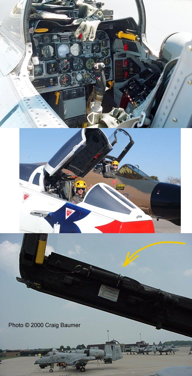

1. The teeth on the Randalls were not originally intended for sawing wood--they were put on the military models to be used in escaping from downed aircraft.
Therefore, the design shown on Crutchtip's close-up above your last post might be the best for cutting through such things as Plexiglas and the aluminum skin of aircraft.
Note that the "cut" with these teeth is best achieved by sticking the knife through the material being sawn and pulling it toward you--it is a ripping action that can get the fastest results if you were desperate to get out of a downed chopped or whatever.

3. The RMKs do not have any offset to their teeth simply because they weren't intended to make smooth cuts in any material such as metal (look at your hacksaw and you will see the same offset design as on your wood saw). The purpose of the offset is to cut a wider channel or "kerf" in the material being sawn than the thickness of the saw blade so the blade will not bind in the kerf.

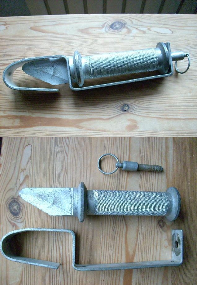

I missed a bit of the moment that the teeth are designed for the cockpit, where in addition to aluminum has plexiglas, and I examined sawteeth in the modern sense of survival, ie sawing all materials. It is possible to consider this sawteeth like kind of Serrated blade for aluminum and Plexiglas.
I think I understand what you mean motion sawteeth to themselves - http://www.youtube.com/watch?v=zApUSw0xsRY
to time 1:15 (incidentally tool for glass has the same teeth)
crutchtip,
I agree with you, it would be nice to pick out the subject of about teeth in a different theme and perhaps not even in the Randall knives, but in general fixed blade.
I used to think that for the release used of a special knife USAF Canopy Knife/Breaker tool.
