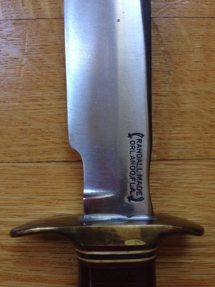

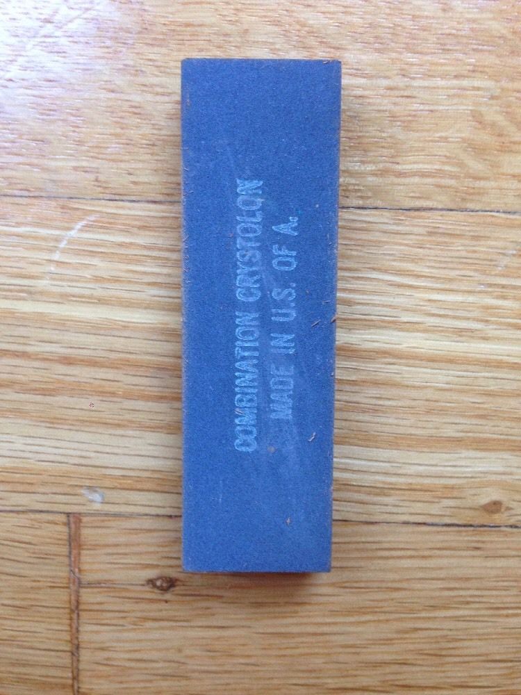

Here are two more photos to help with the assessment of the sheath in question:
