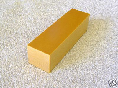

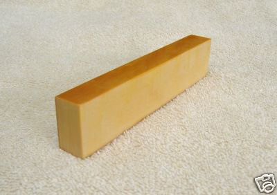

Lets Start with Vintage Westinghouse Ivorite (Paper based M.)
That I know of the 60's and 70's paper (which i have in 1/4" & 3/8") was not the later Recipe as these 3/8" that i will show in Pic. This Ivorite (the very sought after since) was produced probably right around 1980 to 95 from Westinghouse and Very similar from Intl. Paper from 1995 (when they purchased the Micarta Division fr: W-H. (more on I-Paper later posting) there's Clarification tremendously needed on I-P's wonderful Micarta as well. In a Nutshell The 60's - 70 (What's called Ivorite was in fact White Paper) Ages more Caramelish like on some of the Older Mr. Bowles scrim knives. the Later Ivorite (Ivory Paper)Recipe I mentioned 1980-ish to 95 or later, will be Ivory inside and Age to the Lemony Yellow 80ish ~ 95' at least. It is NOT the 1st. Old Yellar" much to the Contrary - the 1st. was on Airplane Props in the 40's wwII era & it was Paper (A~G).So Actually Micarta was made for Comm./Industrial purposes and accidentally this Recipe became a Decorative/Cosmetic (Highly sought) Later. Then the Industrials , such as Insulation & Gears, etc. came. Later the Pure Decoratives such as Ivorite (Not White Paper but Ivorite, as Ant. Gold/ Yellow) were evolving & that, they Did. I'll also show the Ivory Linen in Pic as well. A Decorative Pressed on 36" Square Press Only. I've written articles on the subject of Westinghouse for a Knife Newsletter. I'll stop here for Now, but Glad to be here amongst You folks. Not sure if I can upload Pics.
Thanks , Ken D.
