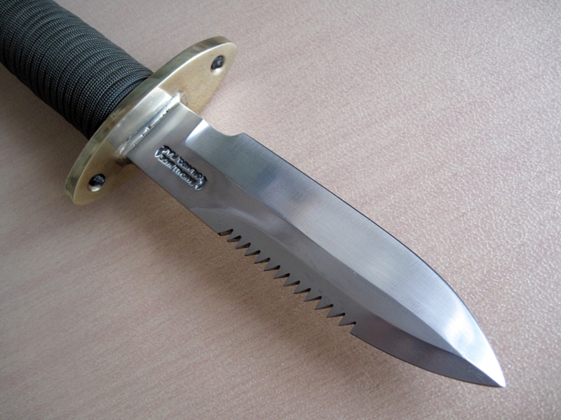

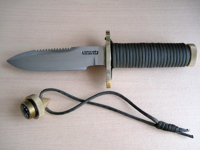

Hi Allen!
I made it without Glue!
Works without any problems!

Really no problem!
You make one end of the paracord hot with a lighter, then you twist the paracord from one of the holes up to the buttcap, back down and in the other hole in the hilt.
Then you cut the paracord and then the same procedure with the lighter!
Thatīs it!

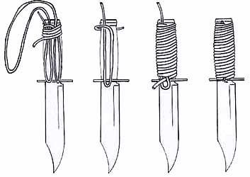

#93787 - 10/14/11 03:54 PM Re: Best way to wrap a handle?? [Re: Holzinger258]
Daniele Offline
Registered: 08/27/09
Posts: 115
Loc: Mondolfo - Italy
pic from Steve's link.
I used this has a guide and it came out good.
hope could help.
best,
Daniele

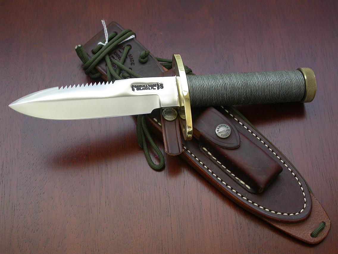

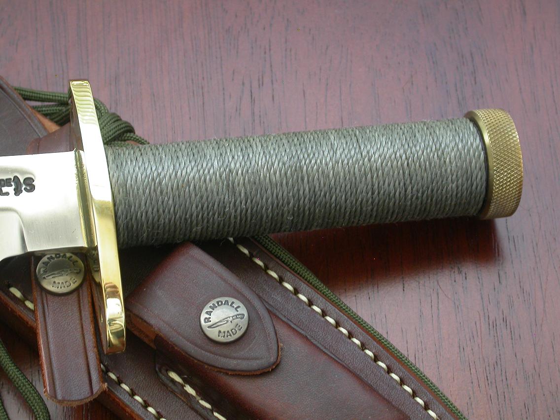

This is the result by following the above instruction diagrams. Although, I wrapped both my 18-7 and 18-5 handles 10 years ago when I got them back in 2001. I liked small cord better. smile
