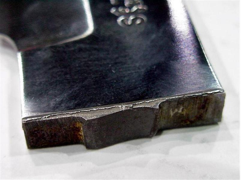

#92963 - 09/23/11 04:19 PM Re: RMK failures [Re: oldguy]
BoBlade Offline
Posts: 1673
Loc: Kalifornia
Joe,
Only one other instance that I can remember in the last 10 years as follows (This one in 2006). You need to be a member to access the site. I've copied and pasted an excerpt:
http://www.customknivesandguns.com/ckgforums/showthread.php?t=1597&highlight=randall
[i]A friend of mine tests all of the knives he's going to deploy with by chopping on an old, damn near petrified, oak log......
Here's an example of why he does that before 'betting his life' that they're gonna work as advertised........new, out-of-the-butchers paper, never used.....but one chop.
I was told this happened because of a heavy grit grinding scratch that was missed before the heat-treat was done, causing a stress riser that resulted in catastrophic failure of this knife.

Wow Ron, that looks exactly like mine. Be interesting to hear how CrutchTip spins it though. It has to be operator error or something like that. wink

Very Good Post and Pictures Ron.
Obviously a very rare possibility of the Randall Knife failing
but the photos are very similar in the type of failure. One chop, huh?

#92995 - 09/24/11 05:25 AM Re: RMK failures [Re: Tom Vaught]
kalervo Offline
Registered: 09/28/10
Posts: 1077
I woulg guess the heat treating went wrong somehow.
On the pics the tang broke. The tang got heattreated to hard and snaps. Mostly the tangs is not need to be heat treated.
Sweden
Knifemaker
shag #29

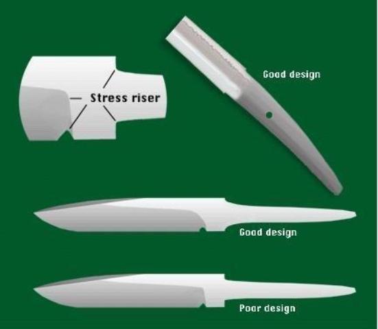

#93379 - 09/30/11 11:12 PM Re: RMK failures [Re: Captain Chris Stanaback]
Posts: 2860
This was sent to me by a fellow member in response to a post from another member that mentioned "stress risers"
You will notice in the photo from Ron's post there is in fact a radius at the tang, albeit a small one, but a radius nonetheless. This indicates to me that RMK is aware that a sharp inside corner is detrimental to the durability of a knife, but is it enough? It doesn't appear the knife broke at the radius, but actually snapped beyond the radius possibly indicating another issue. Comparing the photo to the representations in the diagram, you be the judge.

#93410 - 10/02/11 12:20 AM Re: RMK failures [Re: Tom Vaught]
Posts: 2860
Originally Posted By: Tom Vaught
Too bad that we do not have the other side of the knife to look at.
Randall Made Knives has the knife now and they know the failure mode.
Tom Vaught
ps My main question would be: Why post this "failure" on a international website vs just sending the knife back to Randall Made Knives to be replaced? Why not deal directly with the shop in the first place? Let it go, Joe.
Uhhhhh, Tom, I think you must be confused. You may want to review the threads. So you are clear, this is NOT Rainy Day's knife, but a copy of one of the photos Ron posted of a different knife.
And Rick, this is a legitimate subject and thread. Perhaps you also mistook the intent as well as the content of my post like Tom did.
I think it is pretty clear the purpose of the post and the content of same. In case you are not getting it, it illustrates in the diagram where sharp inside corners create the identified stress risers. In layman's terms, weak spots prone to fracture.
The photo illustrates that at least on this particular knife, RMK did not have a sharp inside corner and the fact that the tang did not break at the transition from tang to blade, but the tang itself broke.
