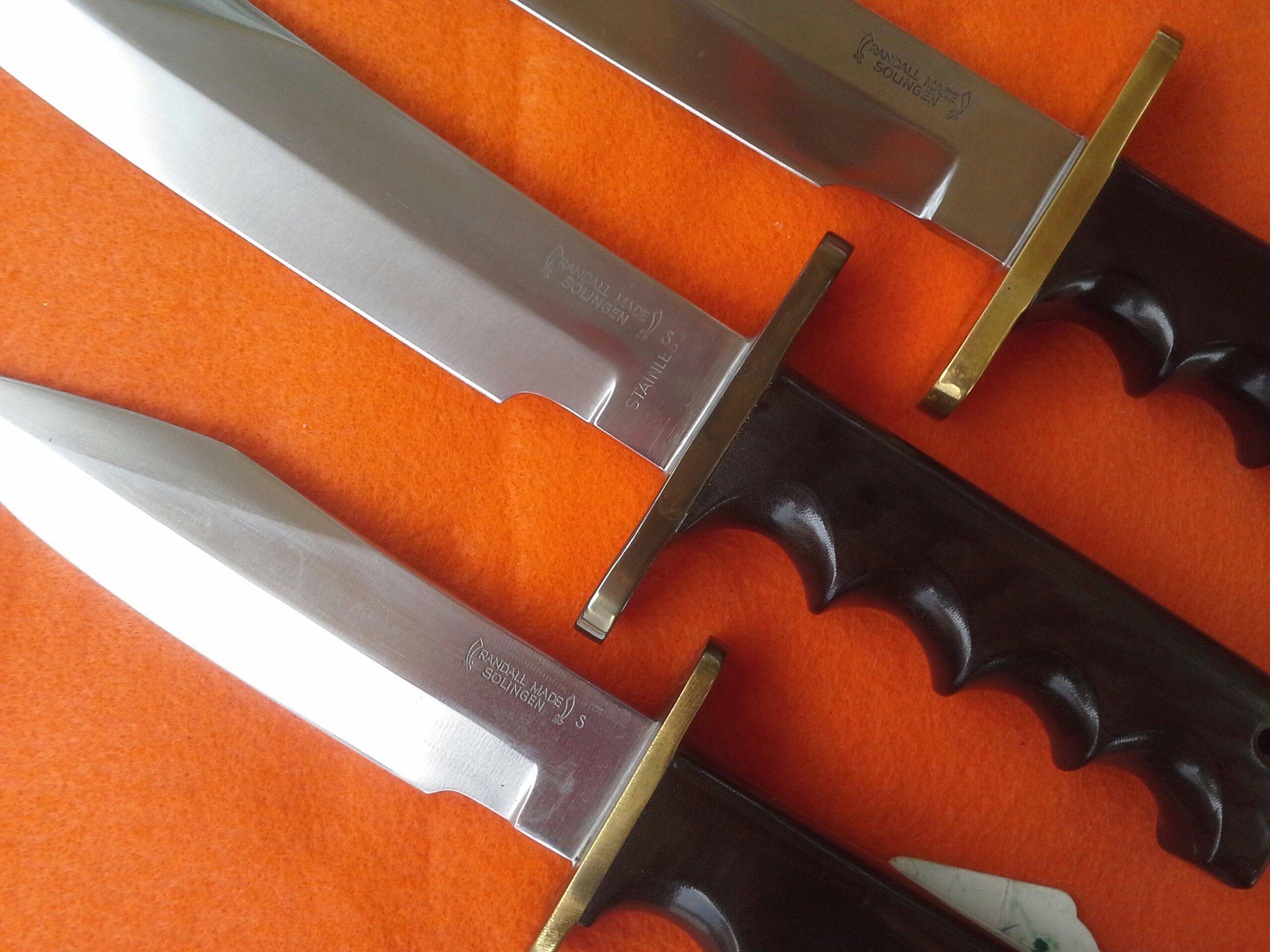

#134020 - 11/19/15 08:00 AM Re: differeces between etched and stamped logo [Re: Andrea Bertelli]
Here are a few of my Vietnam era Solingen 14's and 15's.

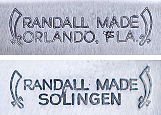

Question Andrea (Andy) asked was referred to ORLANDO stamps...
We do have some "Orlando"...etched and some "Orlando"...stamped...
Why &...when ??

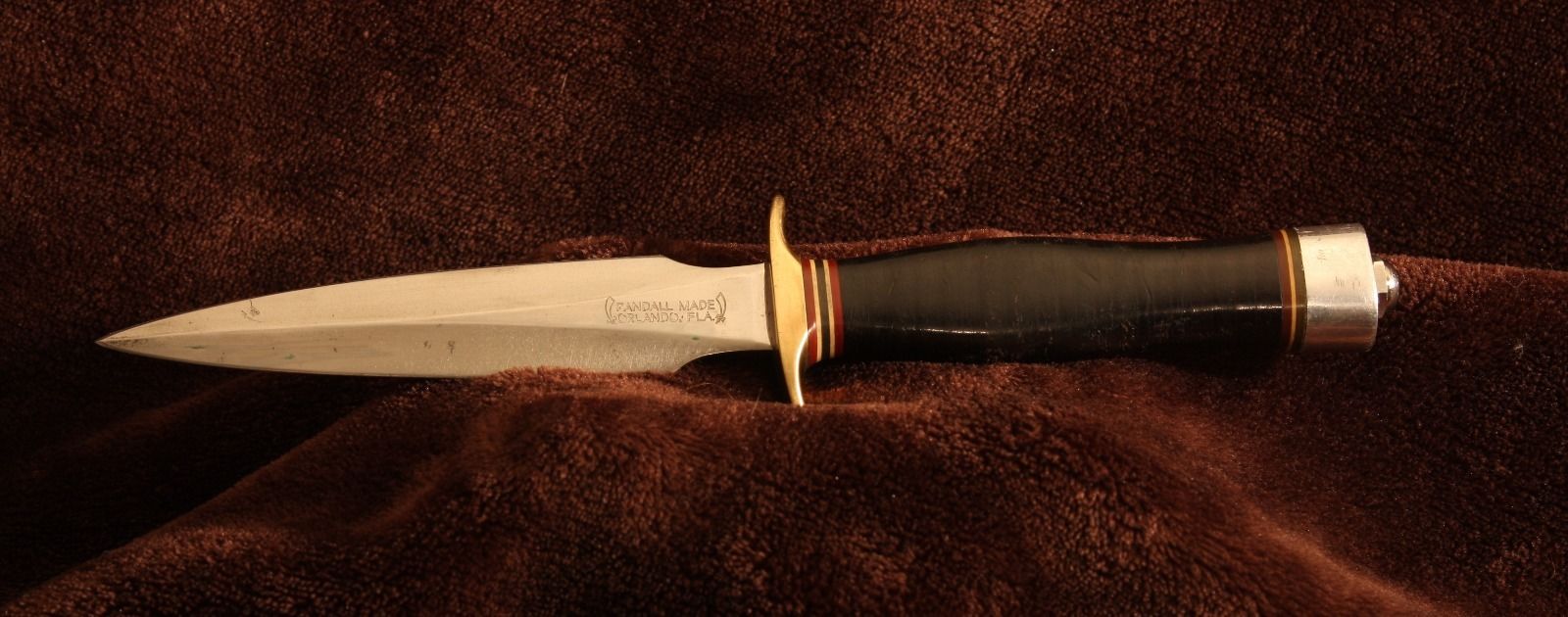

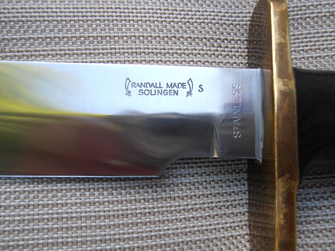

#134998 - 12/14/15 10:05 AM Re: differeces between etched and stamped logo [Re: Andrea Bertelli]
Here is an etched logo on my 1969/1970ish Smithsonian and another on my Model 2-5" Stiletto
