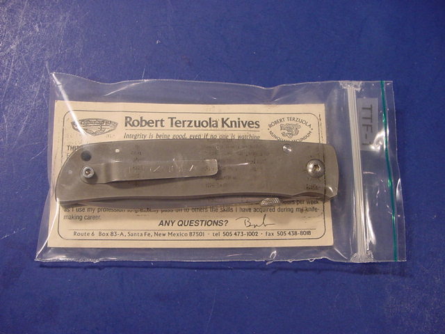

This is a Terzuola Titanium Folder - 1 or TTF-1
I dug this one up to add it here. I carried it maybe twice and put it away. It has a very smooth action. Locks up tight. I believe this to be a Tough folder.

Eric, that is one fine solid knife there, for sure. With today's increased pivot diameters, increased lock thickness, light strong metals construction, we are in a golden age of folders.
Lockbacks, too, nice and big and tough, eclipse the days when the Buck 110 and Harley Sportster ruled the bad boy roost. Bob makes excellent knives (and that spearpoint blade looks tough as nails), and so does Mel Pardue, who pretty much has moved on to liner locks, today.
And, Eric, I have never seen the Terzuola up close, and very much appreciate the close-ups of construction. I might need to git me one o' doze. As for packaging, Hinderer has him beat, his knives come in a zip lock, and ziplock inside a small flip top cardboard box with extra room taken up by a free handful of tactical foam peanuts. AND a signed inspection/assembly card the size of a business card. They all leave the nice current presentation boxes of goodies to Reeve, and nice, it is.
